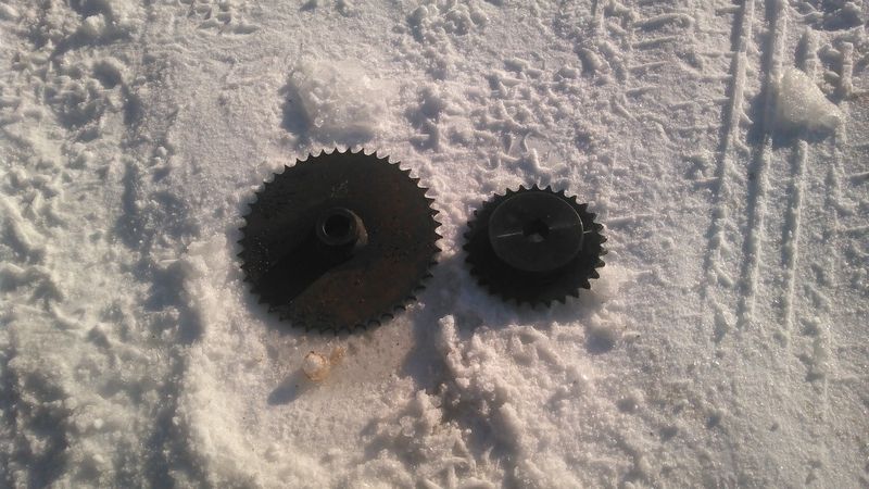

45 tooth worn out driven sprocket to a 30tooth new one:
15tooth drive sprocket, so if my math is somewhat correct:
3.95" drive pulley and 2.95" driven, at 800rpm gives me about 1070 rpm at the drive sprocket.
A 15 tooth drive and 45tooth driven turns that into about 357rpm at the impeller.
Going to a 30tooth driven sprocket gives 535rpm at the impeller, so a fair bit faster. Now I expected it to throw the snow maybe 12-15', and the tractor to bog a little in the process. Well, the tractor still doesn't know the thing is there, and it throws about 20' easily. I notched the auger a bit with my grinder and it's much more enthusiastic about chewing up big icy chunks now.
