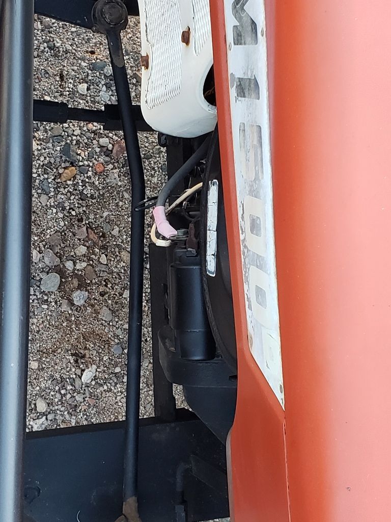

Another issue I have come across, but forgot about until now. When turning left, the steering arm (#63) hits the front axle fill bolt (#32)...it appears to have been doing this for quite some time as the axle fill bolt has one side that is pretty worn down... if you look at the steering linkage in my pics, there is a curve to it, is that supposed to be there? Or is it supposed to be straight?
https://www.hoyetractor.com/CTGY/YM1500G4WDEX.htm
yzrmbsg
Volunteer Poster
Posts: 27
Joined: Wed Jan 23, 2019 7:20 pm
Location: Florence, AZ
Re: New-to-me YM1500D with some issues and questions
Postby yzrmbsg » Fri Jan 25, 2019 6:37 pm
Also..., the tierod (#55) connecting left side steering to right side steering has what looks to be a bend? Supposed to be straight?
winston
Volunteer Poster
Posts: 5067
Joined: Mon Feb 01, 2010 7:29 am
Location: North East Texas
Postby winston » Fri Jan 25, 2019 6:45 pm
Pretty sure both are suppose to be straight.
