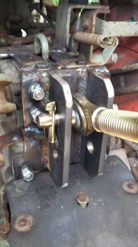

YM1301D fabricated upper link bracket
Postby rallison203 » Wed Apr 22, 2015 1:52 pm
NEWLY FABRICATED YM1301D TOP LINK BRACKET
Ok here's my new newly fabricated top upper link bracket. This was NOT cheap. But it will certainly do the job.
Note the studs installed into the 6 rear-facing bolt holes. He also welded a a couple of plates on top, for shear strength, catching 4 bolts at the rear of the trans housing and under the seat.
Six studs fully seated using red threadlocker. Six sets of nuts and four bolts installed with blue threadlocker. Total of 10 studs and bolts - you could hang the tractor from this thing !!
